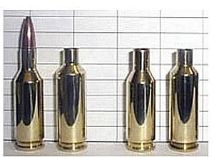

Forming Improved Brass
To create an improved 6 BR case, you must fire-form the factory case in an improved chamber. The simplest method is to load the bullet long so the case headspaces on the ogive. The bullet must be seated hard against the lands, with plenty of neck tension. If you don’t get the bullets hard into the lands, the case can bounce forward and you can have misfires.
Alternatively, you first neck-up the case to .257 or 6.5mm, using an expander mandrel. Then you neck-size the top 1/2 of the neck back down to 6mm (.243). This leaves a false shoulder for headspacing (see photo). A third, somewhat ingenious method, works with tight-necked chambers. You simply neck-turn the virgin 6BR brass part way down to where the new neck-shoulder junction should be after fire-forming. This creates a stepped neck that serves as a false shoulder. Click for full article.
